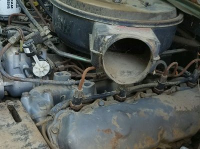

Here are pics of the engine...other than the dirt from sitting for a couple years, i seems to have either been very well maintained or rebuilt/new???
14,778
483

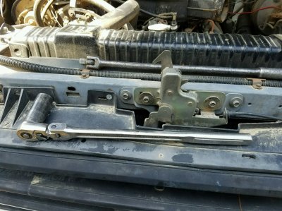

Does it turn over hy hqnd? Rusty air cleaner not good sign. Turn it over 4 x by hand 15/16 deep socket on crank bolt and long johnson bar should suffice.
Hate see ya pull it to find out wont turn over....dont use starter
manimal
Feb 15, 2008
269
29
Cherry Valley,Ca
This is what I used to rotate it...rotates pretty nice...especially for a diesel!
