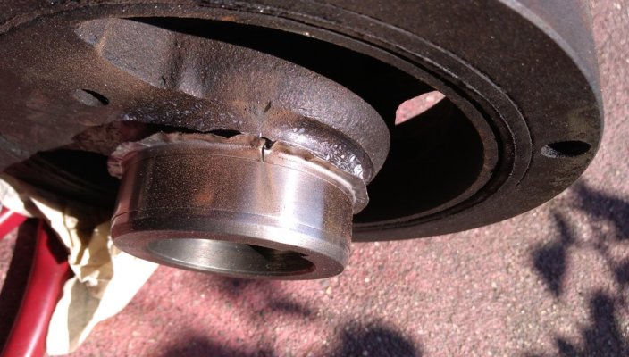

Hello,
with consistent good weather these days I went on to replace long overdue leaking front oil seal.
Harmonic balancer now has visible groove, although caliper barely senses its depth. Please check it out on picture. By look of it can it be
a) just smooth the grove with the finest sandpaper and new seal will work fine for several years
b) or must install a repair sleeve ? The one came with new seal has outside diameter of 2.508" and inside diameter 2.375". That means this repair sleeve requires to machine down harmonic balancer outside surface to hot press it on. Won't work for me, no access to lathe machine for such work.
Are there some thin repair sleeves which can be hot pressed onto existing harmonic balancer shaft ? It will make shaft thicker a bit, and require special "repair" size seal ?
PS. the groove has surprisingly sharp shape
PPS. last time I replaced front oil seal on my truck at 275 kMi in about year 2000, that's 20 years ago. It was done easier than now. My age takes toll....
Thanks,
Sergey

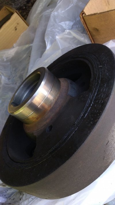

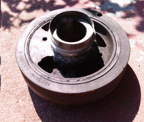

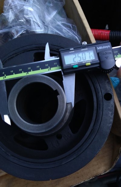

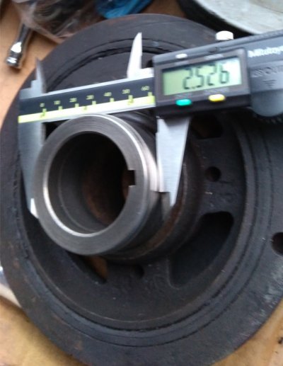

Hello again,
sorry I am bit slow. Finally resumed this task and completed it, by myself.
Firstly, decided not to buy anything from NAPA. For cost reasons.
Instead ordered SKF from Amazon.
My main worry about this product was that its spec says this mode is for 2.500" to 2.505" shaft, and my shaft measured at least 2.506".
Apparently the sleeve went on easily. Either the sleeve stretches easy (hmmm...) or my caliper is out of calibration. Please see pictures attached.
One trouble for me was how to remove the skirt. Even though it is thin metal, I failed to cut it with a cutter. Had to use Dremmel tool with a small cutting wheel. After that the skirt pulled off the same way as from a canned food can (spam type).
Installed back the sleeved harmonic balancer and checked for leaks, so far found none (drove about 4 miles so far).
Written with a hope that these steps will be useful for someone.
