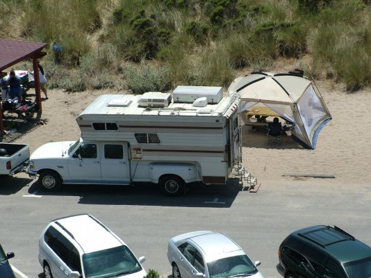

I found a way to put the camper in the bed with that hitch sticking up as it was. I lay some 3/4 ply ahead of it and behind it, and then another sheet of 3/4 ply over the top of the hitch. The camper sat an inch and a half higher than normal, on top of the ply, but that didn't bother anything.
