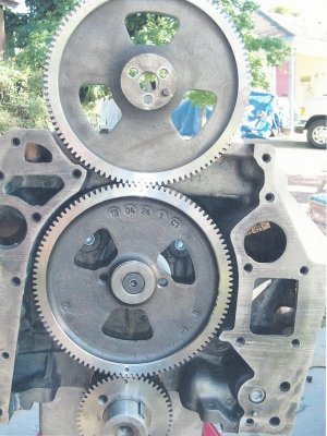

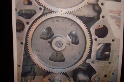

If your talking about the 9/16 combo wrench then yes. Its necessary to have or make one. I was told a John Deere injecter wrench fits and works fine with no modifications. I have not confirmed this yet. But if you have any kind of heating torch like a map gas or an oxy actylelne torch they will work fine. The box end is ground thin like posted and the open end needs both sides ground thinner because they are too thick and will hit the pump body at times. Now as for the three drive bolts under the gear cover. Those are the specail hardened bolts with the 5/16 hex heads. Mel just uses a combo wrnch and his bare hands. I use the 12 point socket and my torque wrench because there is a 25 lbs torque on those hardened bolts. So its three nuts at 9/16 holding the pump to the gear cover. And there is three bolts with a 12 point hex and a 5/16 size socket need to remove them. And one cautionary note.. Never remove the 4 bolts holding the gear cover to the top of the block. I know that looks like the easy way to remove the pump from the engine.. But in the long run its not. What happens if you do it that way is the gear cover, the pump and the injection pump gear al come off as one piece. Then you loose the gear timing and its a horrible job to reset the gear. But it can be done if you need to help. Its just impossible to see down to the cam gear to locate the gear timing marks. This is a picture of the gears with the marks. See how far down the injection pump and cam gear marks are. With the water pump plate in place you have about 3/16 inch to see and feel down there for the "Y" marks. What Russ aka typ4 does is makes a small grind mark on the cam gear "Y" mark. Then he can just look down in there and see that the gear is at the correct position and not 180 degrees out.. Oh yes.. these cam gears have two timing marks. See the dot.. That has to match up to the crank gear. Some members have found out that these engines run but badly if they are gear timed 180 degrees out. That means someone turned the crank till they found the dampner tab zero mark and the damnper set but it was 180 degrees out. The dot was up facing the injection pump gear "Y" mark. It runs but very badly.. Ron had this on a truck his customer just had a shop change the injection upmp on. The trunk monkeys at that so called shop had no idea how to change a pump nor did they gear time it properly when they removed the pump and cover and gear as one piece... Heres the pic for those not understanding what I have posted..
