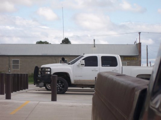

How about this one? I have to admit that this really made me feel like drinking a 6 pack of beer, climbing up on a step stool, and waiting.:sly

Ya know I once thought about doing a massive mechanical dump valve thru routed thru a hood stack on my F250. I have since come to my senses and realized how bad of an idea that could be. My truck is loud and obnoxious enough without blowing my exhaust at my face the whole time.

As far as I know, that is technically illegal in Kansas anyway. From what I remember, the exhaust is supposed to exit behind the driver and a hood stack certainly doesn't do that. That's not saying that I haven't run exhaust that didn't exit behind me. I did for several years and got away with it just fine. I knew that it was illegal and did it anyway. I never could have done that if we had vehicle inspections here, but we don't, surprisingly. I've been expecting it for 20 years or so and it hasn't happened yet.

Yeah we dont have inspection in CT either and have a similar law in place, Exhaust must exit behind the cabin of the vehicle. I usually have my exhaust exit mid way down the truck to avoid having to run it over the rear axle. I have a friend who was pulled over because his exhaust ended a few feet after the headers and they dinged him based on that regulation, although he was pulled over for noise complaint.
