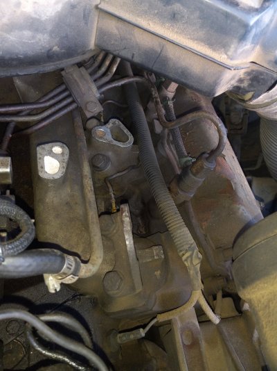

Here is what im looking at #2 inj. Cap does not have the correct.cap.when my stuff comes im gonna run the return from #1 over to #2 im good on the T at #8. And as well.noticed the vaccum pump holes seems to have oil residue, tye fun just keeps coming.
If the other truck didn't need a garage visit i would simply pull this motor i know it needs a rear main seal as well..
I jave.more pics of other stuff but i hate a cell phone lol.
