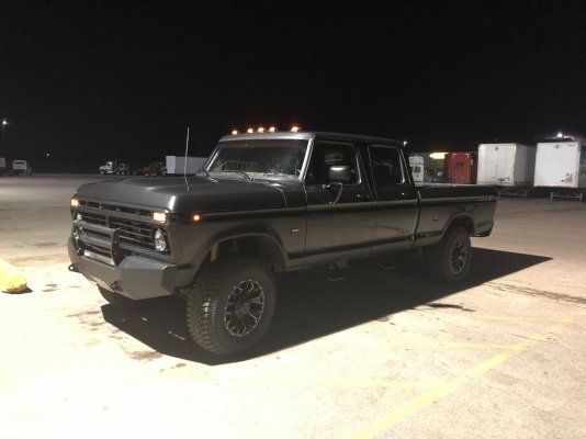

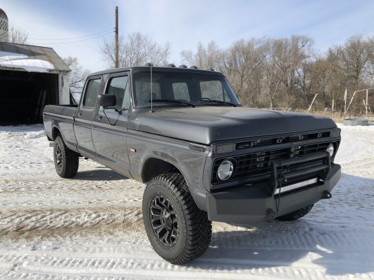

Here are the pics that I got, the front end opening is not as big as the late 80s to early 90 Fords, then add the bumper, this might be part of the problem. A lot of the radiator (about half) sit below the frame rails.

Did you put a IDI radiator in your 75‘? If not perhaps you need a higher capacity radiator.

Not a fun solution but could take the bumper off and see if that helps.
