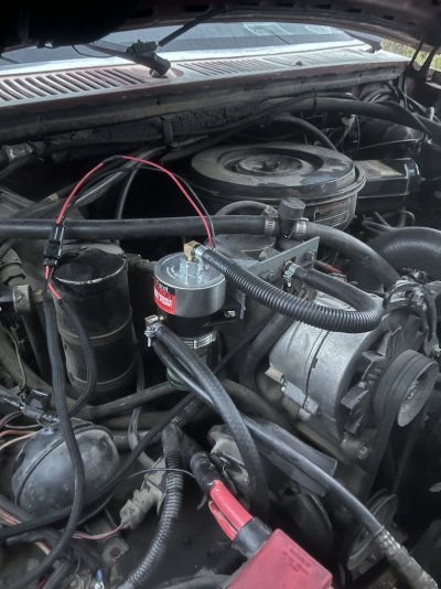

so for series I could mount it to the condenser for the secondary
I really like the mech fuel pump and electric for priming idea
Combines the reliability of the mech with the priming of the electric I think I still have my old mech fuel pump which was actually new as I warranty it out because it split and well you can picture what happened after that
@ The_josh_bear I’d love pics of your mech and electric set up I’m done spending money on more pumps my trucks 5th in a year

This set up has worked nicely for me ('93 IDIT).
My favorite part is the redundancy.
The truck runs fine on either pump, better on both.
I believe that some (most) of the reported Facet failure is due to "knock-offs" being distributed/sold by bad actors.
I buy mine here: Pegasus
