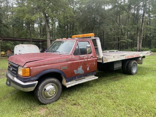

I bought a 1989 F-Superduty rollback and have been going through every system on it. The truck was a total mess with nearly everything rigged or broken on it. I replaced the entire wiring harness from a 1991 donor F-250. Every thing works as it should now, but am wondering now if it is possible to add rear antilock to the truck given that it has rear disc brakes. There’s even a speed sensor in the rear end which to me would serve no purpose other than rear antilock. The only thing I don’t have installed yet is the antilock valve assembly that mounts on the frame rail. The truck even has the two lines capped off there from the factory. Does anyone have any info on this?

Fords of this era were built to be modular, to mix and match features, I'd imagine you could just drop everything in and it'll work, however I'm unsure if the braking distance would be the same with discs versus drums in the rear. But I don't see why it wouldn't work.

The point of the vss is to sense when the rear wheels locked up and tell the rabs so it can pump the brakes for you. Questions:
I can tell you for sure that the fsuper duty non rollback didnt have rabs. I think the f350 dually that year did have rabs. I would assume it's the same rear end but on the superduty they plugged the vss port. So did somebody put a disc brake conversion on a bricknose DRW axle or is this a newer factory disc DRW that was swapped in? If it's the former, you would just replace the f superduty bypass with a rabs and plug the vss in.
Yes the 350 dually did. Completely different rear axle though. F-supers used a Dana 80 rear with discs factory if I recall correctly.
The f-super is what everyone pulls the bypass fitting off of so I'd imagine ABS from a 350 should bolt right up as long as it has the correct signal for everything.
