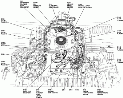

338
Just to clarify the things.
The sensor on the layout that says "Coolant Temperature Switch" that is the one that operates your temperature gauge.
The sensor on the layout that says "Engine Temperature Switch" is the one that turns ON the dash light, whether it's "Check Engine" or a "Picture of a block .
If you look close by the #1 GP , you can see the Sensor Switch that triggers the Cold HI Idle Solenoid and Cold Advance Solenoid on the IP.
