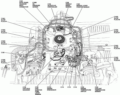

338
You can probably find it from this.

Check the link I posted. When I started ID'ing my sensors I used the diagram above and so didn't find it. That's because it's under the A/C compressor, if you have one. It's on the front of the driver's side head. The diagram OldBull posted does show the location of the gauge sender though. It also doesn't show the temp sensor right next to the t-stat housing. That one is only for the cold idle solonoid.
