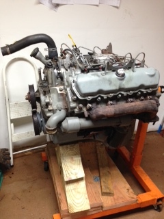

I'm using one thats rated for 1250 pounds. The owner says he had a powerstoke on it for months. It did hold the idi but I was nervous so I blocked it up until I got the heads off.
