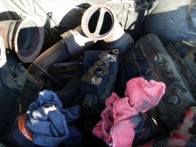

early 99 is on its own.
99.5 - 03 is bigger , also has 3" mainfolds, and the uppipes are different., y is also different
later will swap, but need all the stuff to do it.
adrian-
here's a pic of the uppipe outlet to illustrate the difference. if you do update, you have to do the whole nine yards.
