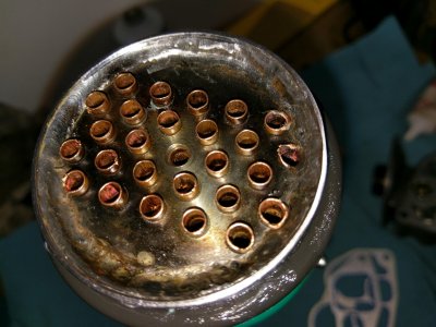

I actually just got one and put it in yesterday in my 96 PSD. Its a solid nice looking piece, says made in China, the o-rings are good and the gaskets are good but they welded over one of the tubes when they put the ends on. So far no leaks and i dont forsee any but it sems like poor quality welding to me.

MTKirk
Nov 29, 2015
405
24
Billings, MT
Thanks for posting the pic. That looks truly awful, I hope it works out form you!
Shawn- thanks for posting that pic of the oil cooler up. I know it is for a PS but gives us some idea of the "quality control" Dorman is using. I would think they would have to be pressure testing these things before they go out the door. If it passes the pressure test, the cooler gets shipped even if it is a bit "ugly".
Shawn MacAnanny
Feb 12, 2016
818
44
Delaware
I wish id taken a pic of the outside, the thing was solid and a super high quality piece. It's just a shame they welded over the tube sheet.
