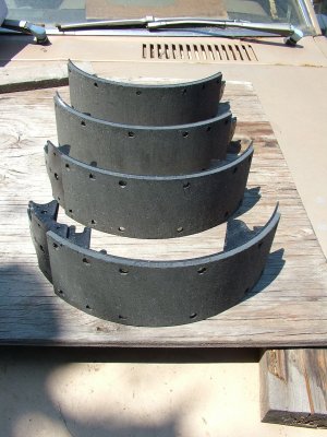

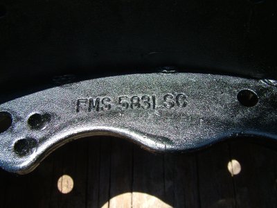

I have no complaints yet about the shoes I put on the rear of the dually. The box says they are Wagner ANA 583R. They seem to be working well.
