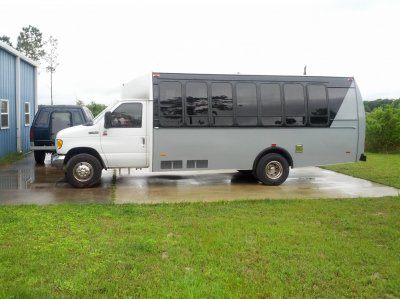

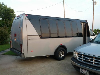

Also been doing some paintwork. So far I have painted all of the bus body. Still have the front to do, but decided to wait a while.

Looks good! ;Sweet
Are you using this bus for a commercial operation, or is the bus for private use? What does the inside look like?

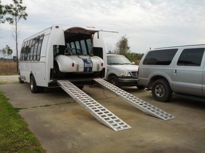

I have transformed it into a Cobra hauler.

ok, I see, two seats in the front, and sometimes two in the back! LOL
Cool idea!
