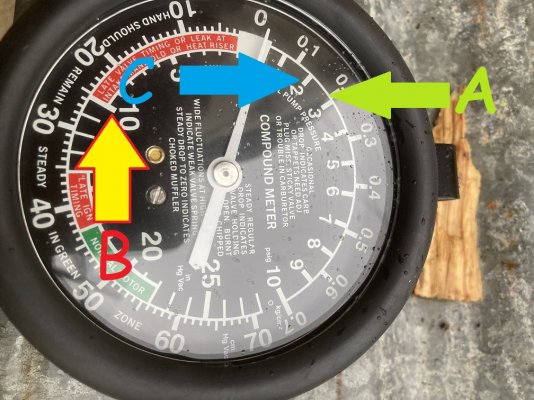

dang! guys! you and this forum are sssoooooo ggoooooddd!
we have a saying here, "messen ist wissen" "meten is weten" or "measure is knowing" and again, that's king!
It will be more difficult if you don't have the right tools for the job, but.........
Anyway, I found how to measure the fuel pressure, and what do you think?
engine running stationary warm, 2,5-3 Psi.
When accelerating a bit the needle plummets to below 1 Psi.
hence the filter restrict light comes up every time running higher Rpm's, the IP is pulling fuel through the lift pump right?

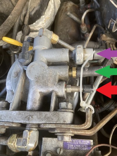

5psi input is what these IP's are calibrated for, according to the guys that actually rebuild them, which I why we say 5psi.
1 psi is acceptable, but not ideal. You have a problem that you're pulling a vacuum at higher RPM's-- that's a problem. Whoever you believe, you still need pressure at 3000k rpms and you're not getting that. So you have a plugged up filter, weak lift pump, or other restriction, perhaps at the tank. Doing the bucket trick is a great way to narrow down the variables.
If you can get a gauge for that filter header that's great, the best spot is the vacuum switch port, 1/8" NPT. Probably not standard in France... But that's what it is. If you measure at the Schrader valve port you're measuring BEFORE the filter and won't have an accurate reading. Because what you need is AFTER the filter to know how much pressure is getting to the IP.
Even better if you can get that gauge out where you can see it while driving. Then you'll know all sorts of fun info while driving around.

Does anyone of you know if I still can get, and so where? the Airtex mechanical lift pump for these engines?

Image of filterhead; Am I right in assuming that Red and Green flash are BEFORE filter? and Violet flash is AFTER filter?
with my test I used the green connection, because I couldn't get the vacuum switch out without destroying it, didn't feel too much for doing that :-(
My test, as said on the green connection: warming up the engine on stationairy, had a pressure of 2,5 - 2.8 Psig light green flash on the image.
running the engine up to 3000 Rpm for two minutes, pressure dropped to -10 Inch/Hg vac.
Then released pedal, Rpm's back to stationary, pressure came up, but did not depass 2 Psig.
then weather declined and was too bad to continue.
