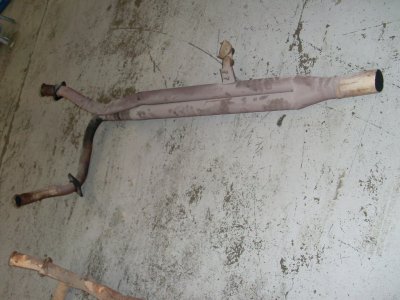

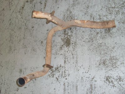

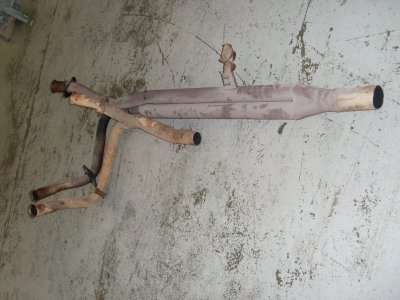

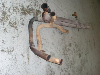

i unfortunately got delayed from most errands this week thanks to an extended "lab rat" stay at the VA. but I did pull apart a rather interesting exhaust setup this weekend. take a look at the pics and let me know if it interests you. obviously, the shipping is going to be interesting.
