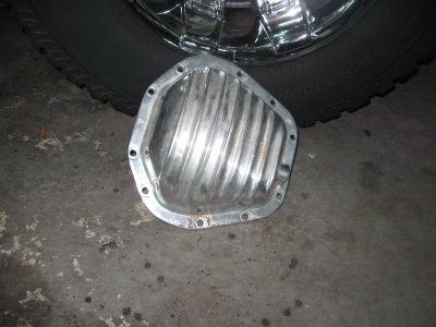

I am betting that this one would fit. If you want I can get you the measurements and let you know how much more it sticks out compared to the stock one. Let me know!
Later,..
If it EVER stops raining out there, I';ll have to crawl under and measure that clearance. I got stopped dead in my tracks last night by a downpour in the middle of a bunch of tranny work.
It sure looks like that cover would fit though. It doesn't appear to stick out more than about an inch further than the stamped steel one

Hey Darrin, it finally stopped raining, so I could get under there and measure the clearance between the diff cover and the nearest obstruction, and it looks like I've only got about 2 1/2 inches there. I remember it was pretty close just getting the factory cover off and back on wiggling it over the ring gear. I know when I go to rebuild the posi, I'm going to have to drop the whole axle out to be able to get the thing apart.
Does it look like one of those covers would be able to wiggle in with that kind of clearance?
Sorry it took so long to get back yo you but from what I can measre, it looks ike this cover sticks out about 3/4" to 1" more than the stock steel one.
I say if you are going to rebuild the rear end, install the cover at that time and you will be good for a long time. You also may be able to loosen the shocks and let the rear end drop a little more if you ever do have to remove it.

Thanks to Craigslist and Fed Ex I got my Dana 60 front end cover in the mail yesterday. I will scuff it and paint it to match the rear cover. It will get installed when i get the 3:55's and Detroit Locker installed.

oh dear lord...:rotflmao:rotflmao you know i've been wondering if i could get a cover that would line up on the bolt circle of the D50 up front. i'm thinking about chopping out the housing and making it a removable cover but not sure if it would hurt the structural integraty of the driverside axle.
