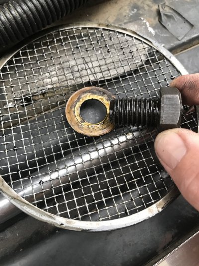

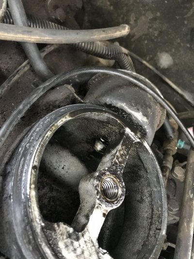

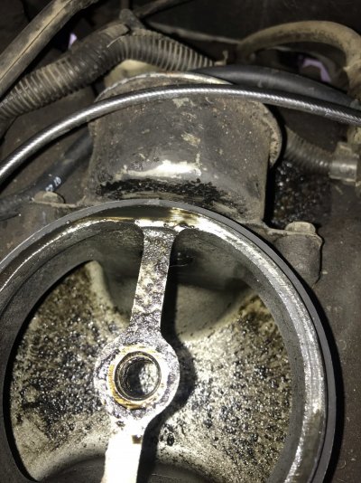

cant remember the name of the oil but its blue and it says endorsed by cummins anyways I've had best luck with burning oil with that brand, as for the cdr pop the intake off and look into the plenum if your cdr is bad there will be oil all over your intake and a small puddle where the cdr connects into the intake, i haven't seen a idi not burn at least some oil via the cdr but you can tell when its bad enough to cause that amount of consumption, I soaked my cdr in diesel and that slowed it down some but I never keep good track of my oil consumption
