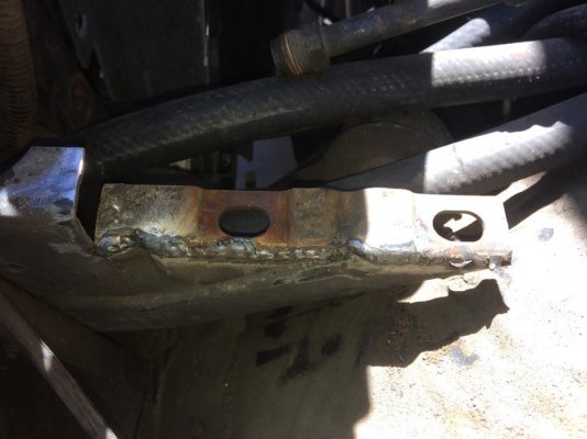

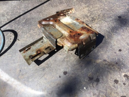

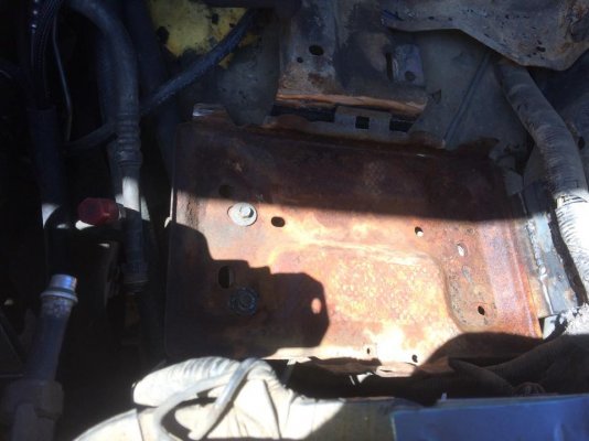

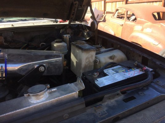

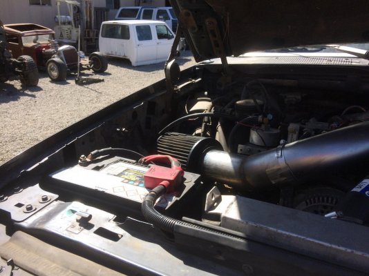

when i did Andrews truck, i didnt like how they fit with the factory battery trays.
i dropped them down an inch.
then ran new cables.
bring some 1/4" 1" strap, some 2/0 lugs, some good shrink wrap, and a 12 pack, well get em done

So you just sectioned the mounts and dropped em an inch?
I've not had them out to look yet.
I replaced the Eastwood welder with a Miller :sly
How was the vaca?
See you soon
13,320
3,885
How was the vaca?
See you soon
yes sir. its actually very simple for the like minded .
