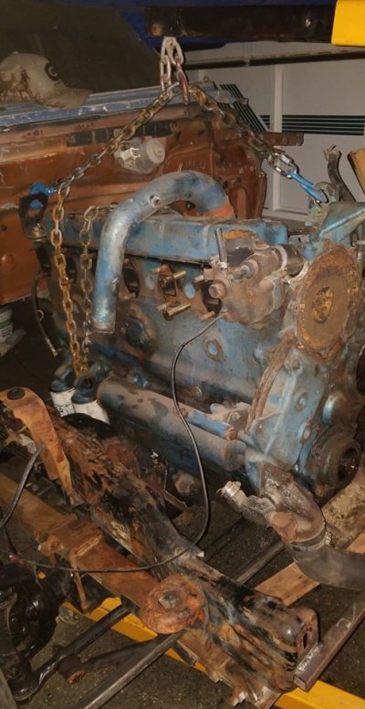

seen a couple 360 builds.
my buddy tried to do a 466C in a 86, but lost interest, had to be chopped 5 ways from sideways...
Austin86250
Oct 5, 2021
839
483
idaho
I’m not familiar with the dt360 can someone enlighten me as to why it’s a worthy swap?
2,384
2,436
It's a straight six that was made as a competitor to the 5.9 Cummins, does about 170-190hp. Mostly used in farm/industrial equipment.
