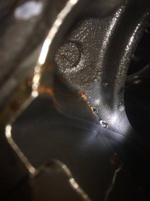

i have personally delt with several cracked heads, resulting in billowing white smoke.
ive even had cracked blocks.
easy enough to pressure test the coolant system and see if it leaks down.
