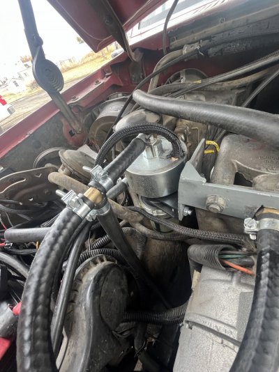

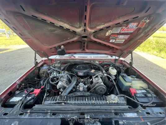

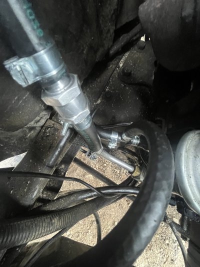

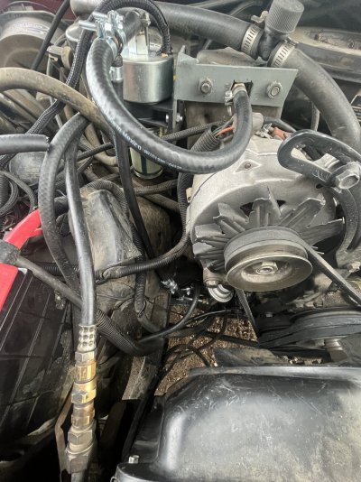

For the ultimate in redundancy make sure to put the e-pump in parallel with the lift pump. This is how I have my Facet pump. That little cube will get you home but that's about it. It's not enough for towing as you'll lose some power. Just be aware of that.
It's easy with 3-way connectors and a check valve in each line.
@Selahdoor has a good write-up on the matter that I can't find using the google machine. My google-fu has weakened!
The reason for parallel is so the cube pump won't push fuel through the mechanical in the event that the mechanical ruptures it's diaphragm-- then you'll fill the crankcase with diesel and have a really bad day.
Also make sure the cube is after the main fuel filter. That little pre-filter on it clogs easily, ask me how I know... took me 2 days to remember I even had a pre-filter. Those were 2 long days of tearing my hair out, lol.
I’ve lost count but I’m on my at-least 5th mechanical pump 2 delphis and 3 Carter’s I just put a precision one in today hopefully that goes better and they have failed in every way possible, weep hole dumping, diesel in oil, no pump, and my personal favorite the output fitting split spilled about 10 gallons in the road and gas station it was there for days
That’s what I did after trying 2 models of the facet I have no clue how anyone got them not to starve about 2700 rpm’s for a minute or more
Not wanting to waste all the money I got into them I just mounted it to the side of the fuel filter and ran a switch into a dash it has saved me twice now
Now I highly recommend to anyone running a mech pump to have a electric primer pump it’s very handy
I teed the supply and put a check valve onto the mech output as to not pump diesel back into the crank case incase if diaphragm failure one day I’ll upgrade from standard fuel line to pushlok or AN
I also had a solo carter 4070 actually worked great for 6 months I towed, did long 80 mph+ pulls with it Too bad it proved itself to be unreliable
I do like the Holley red a lot but haven’t ran it in a idi just my 460 it’s robust and I don’t doubt it would meet the idi requirements while it is loud but not as loud as a fass, airdog, or holley blue
I hope one day someone can make a mech pump worth a damn as that’s my preferred route, I heard they are rebuildable maybe that would be a good business plan I know I’d sure spend 100-200$ on a quality pump maybe they can even be set for higher outputs for bigger ip’s/ boosted applications
