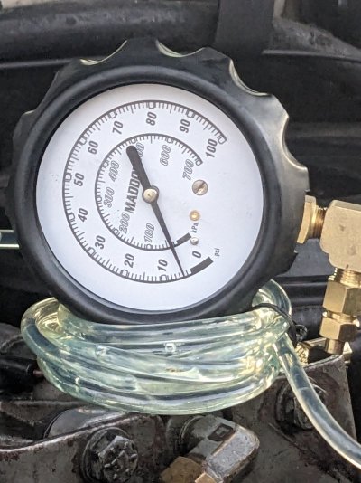

Well, the Carter pump is installed. Truck appears to be running great.... however the pressure is lower than desired. I am going to try and troubleshoot/correct a few items tomorrow.....bends in fuel line...ect...and see if the pressure does not rise. I am just hoping the cam lobe is not too worn to effectively run a mechanical pump...guess we will see.

The wider the range of the gauge generally means a drop in precision. Especially with a HF one like you got there. Doesn’t mean def what’s going on but keep that in mind. I have 3 gauges on my fuel pressure. My two narrow range ones read exactly to what I have the regulator dialed in to, 5 psi. My 100 psi gauge reads like 2.7psi when it’s actually 5.
