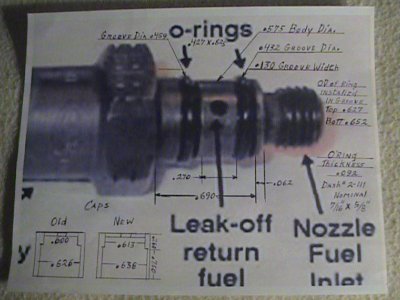

So Here is some of the measurements and pic with measurements on injector and o'ring, caps in lower left corner.
I measured six (6) different injectors, 2 were made in Italy, other 4 by Delphi.
All measurements were within a half thousandth between the six. That's holding really close tolorance.
All measurements were taken with a Digital Caliper. Some measurements where + 0.0005, discarded that.
The Old cap, still with Gray paint on it yet from a 1990 IH.
New Cap was made in Germany, with IH part # 180557 I think.
You can see the O'ring groove depth is not alike, the bottom groove Od is .459 and top groove is .432, so actually there is a stretch of the bottom O'ring of .027.
I could lay a ring flat and then try to pick it up with the cap over it, some caps, would some wouldn't, that was out of 4 old would and 4 new wouldn't.
Draw your own conclusions from this. No the caps are NOT to scale.LOL
