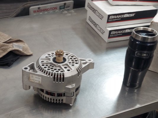

Russ (typ4) was the one who told me about the adjustable voltage regulator for the 1G alternator 12 years ago. I contacted him a few day ago and apparently they are now discontinued. He may be able to get ahold of one, but for now I'll be putting this in. It just showed up at the Post Office this afternoon. It's in good shape; no complaints.

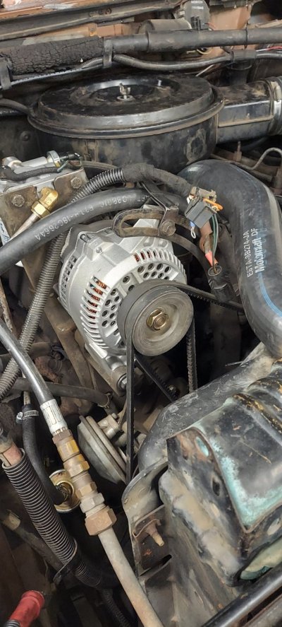

This is where I'm leaving it at tonight. As has been mentioned elsewhere, the bolt hole is too small on the 3G. A quick pass with a 5/16 drill followed by a little threading with a 3/8-16 tap and I could use the 1G bolt.
A couple of observations: the boss on the bottom of the 3G alternator was about .003 too large. I took a file and barely knocked it down and it fit perfectly. Also, Mr. Roboto's thread in the tech articles mentions he used a 2 mm shim under the pulley on the 3G alternator to have it spaced correctly. The difference between the two alternators I have was less than 1/2 mm, so I'm just gonna run it. If it throws the belt I'll shim it out.
