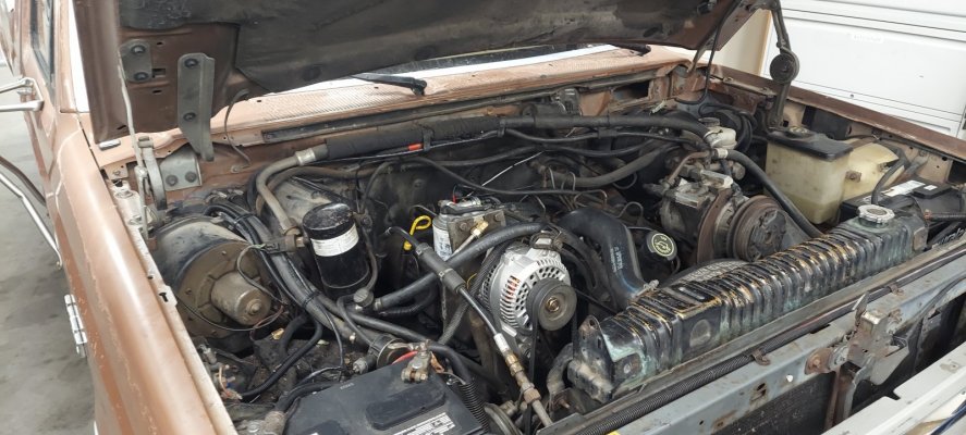

I got the 3G alternator installation completed along with cleaning up all of the wiring in the engine bay (I had forgotten how time-consuming pulling out unnecessary wires, cutting out extra wire length and sleeving all of the exposed wires with split loom is). I don't like seeing colored wires in the engine bay, it's gotta be all black to look decent to me. (The white wire will be covered by the air cleaner.) I haven't yet started it to see the difference in voltage output; tomorrow I'll be installing freshly rebuilt injectors with new fuel return lines and caps. If everything goes well I'll start it tomorrow afternoon.

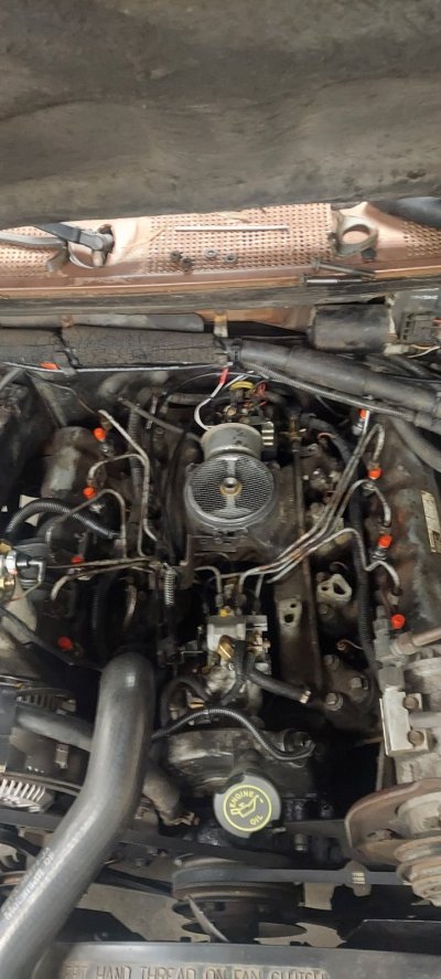

As far as I'm getting today. This was the first time I've removed and replaced injectors in the truck. It wasn't hard (the order of operation is self-explanatory), but it sure takes some time. It took a couple of hours just to clean the caked-on yuck in all of the injector bores. (I'm not as young as I once was and laying on the engine took it's toll.)
Best helpful tip I found on OB: if a copper washer is stuck at the bottom of the injector bore use a 5" or 6" long 5/16" lag bolt. I simply threaded the bolt into each of the five stuck washers about three turns and used a slide hammer to yank them out. I'll have the caps and lines installed tomorrow and then I'll see what the voltage output of the 3G alternator is.

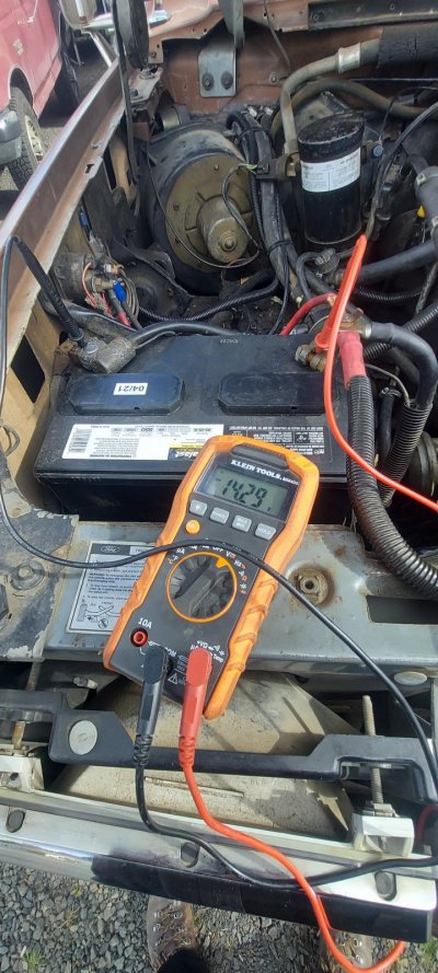

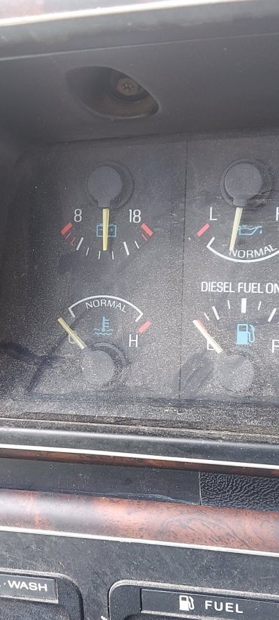

I got all of return caps and lines installed, double-checked everything to make sure I hadn't overlooked anything obvious, hooked up the battery and gave it a crank. Surprisingly, it didn't take that much cranking (maybe 10 seconds) and it fired up. After a few seconds of rough idling it smoothed out. I was pleasantly surprised, there was an improvement in the sound at idle... smoother, I guess? I let it warm up for a few minutes and observed a noticeable improvement in voltage output: there's a full volt more than the best reading I observed with the 1G alternator! I am very pleased with this result! (Also, I waited for a few hours after my test drive and checked the resting voltage of the batteries: 12.65 volts. My experience says your batteries really need that extra volt in order to stay fully charged.) My takeaway: if you're having a low voltage output with the OEM alternator, upgrade to a 3G. It's a noticeable improvement.
Also, the fuel injector replacement was a great upgrade as well. I had a noticeable improvement in throttle response and power. There's a hill about a mile north of my house that's roughly half a mile long. Before the replacement, if I was traveling 60 MPH when I began to climb it, by the time I got to the top (with the pedal to the floor) my speed had dropped to 55 MPH (with the truck unloaded). Now, traveling at 60 at the bottom of the hill, I was able to accelerate to 65 MPH by the top of it. I certainly won't be winning any races, but the condition of the truck is moving in the right direction. There's still a fair amount of work to do, but I am very happy with both the 3G alternator upgrade and the fuel injector replacement. I still need to get it timed, so I have one of the DTI timing sets from eBay on the way. It's supposed to be here between Wednesday and Saturday of next week (hopefully Wednesday). Once I get that accomplished I am confident she'll be running great... and maybe then I'll turn up the fuel. :sly

The only time that the needle on the factory ammeter in my Blue Truck moved was after I did the 3G swap on it. So it does make a BIG difference.
