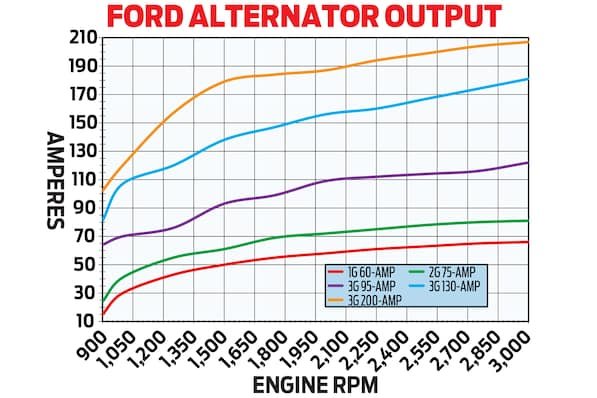

This may interest you. Your alternator is probably 60 to 70 amp output. If you do the 3g upgrade if your alternator needs replacing you pick up almost 100% amperage output. Then you’ll see about 14.4 volts charging with everything running.

EDIT: I see @gnathv posted a pic, but it's a little small. Here's a full-size version:

YES you need an upgrade 3G alternator. Your truck has more electrical load than you think and the current alternator is NOT keeping up with the load(s).

The 130a 3g will do more good than you think and will be able to see at night with standard headlights, it also cleans up wiring that can give issues.
