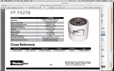

45 gph is over double what we need the racor 7 micron that fits our trucks is only rated at 20 gph. I have ran a racor 200 turbine style with 2 micron filters and that is only rated at 15 gph with no problem.
