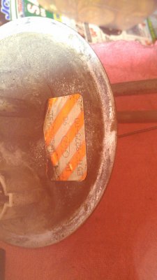

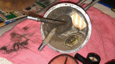

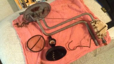

Found my fuel sending unit issue!!!!!!!
Damnable FLOAT!!!! -cuss Thing split, and sucked fuel.:mad::puke: Going to see about getting either a new one or one form a junk unit. Will post pics of unit, which is surprisingly new looking and has a ford part tag (D6 FORD E5TF-9275-DD).;Sweet
Only one problem :mad: With the sending unit being mostly good and the tubes NOT rotted.. WHERE THE HELL IS THE AIR COMING FROM. -cuss Which brings me to the simple solution : the guys down at knechts treat me like I work there. THat said, parking lot line change -._ Gonna just convert all those damn lines to 90% hard line 10% rubber ( Rubber where hard line wont fit connections I.E. : sending unit tubes, 6 port selector valve tubes, etc.)

Float
yeah, the float on mine is cracked and bad, but the circuit board is bad too. only registers tank at 1/4. the only part of the sending unit thats good is the piping. go figure...
