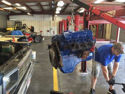

Buddy volunteered to help me put the motor in. It needs a little more wiggling to get it all the way (we ran out of time), but it's real close.
Yes, the exhaust manifolds were on the wrong sides at first. One of those days.
