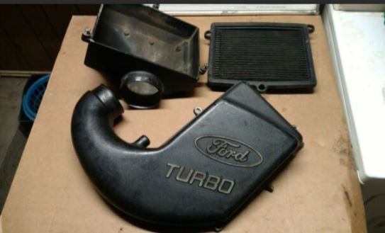

Recently bought a 1989 F250 that previous owner swapped in a 1991 7.3 IDI but they did not transfer over the original turbo that was in the 1991 truck. I have all the parts. Is this a huge job, i'm fairly mechanical and have room to work on it.. but also is it worth it or should I just leave the 7.3 as is naturally aspirated. Engine starts and runs great.. i use it for pulling trailer with compact tractor. Engine has little over 90,000 miles on it.

91 didn't come from the factory with a turbo did it? That's an aftermarket turbo correct?
I'm not sure.. this is what I have. if its not from that 91 7.3 perhaps they just picked it up from a later year and just never got around to installing it. I'm wondering if its worth the work or not..

I also turbo'd my 89 with the same kit(that's an OEM Ford setup from '94 BTW, made by ATS) and I absolutely love it. Took me a while to dial it in between it being a bad turbo to start with and exhaust leaks, but once it was up and running there's really no going back. They can add 50% more power to the ground with a maxed out IP.
If you have the mechanical ability and room to work, absolutely do it. Make sure the turbo center housing is in good shape so you don't have to pull it soon just to rebuild it.
I'd say it's about the same kind of job as changing a transmission as far as difficulty, minus the heavy lifting. Basically it's not complex but still a good amount of work. Having a buddy is a big help. Having all the right parts first is just as big.
