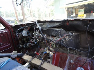

+2 on removing trans and transfer case. I removed my engine leaving the T19 trans in place, but once out the transfer case rotated the trans, so there was no way it was going back in without removing the trans and tc. Remove starter and oil filter to help clear front crossmember. With the transfer case off you can pull the transmission back to clear without lowering it to the ground, but the transmission crossmember has to be swung out of the way. The bolts securing the trans crossmember are a pita, 15 and 18mm if I recall.
