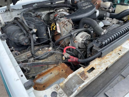

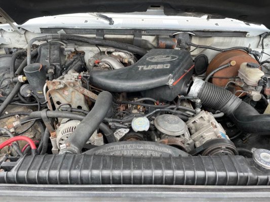

So I got my hands on the motor from the above listed truck. 179K. Said it ran but not well. Need to build a stand for it and figure out what is what. Perhaps try to start it on the stand and see what not well is. Got everything but the down pipe and the intake to the ATS box. No oil in it so no intel there.
