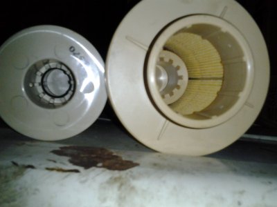

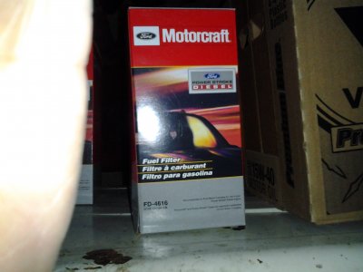

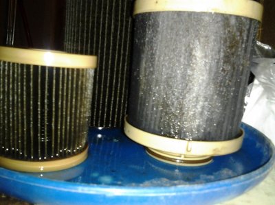

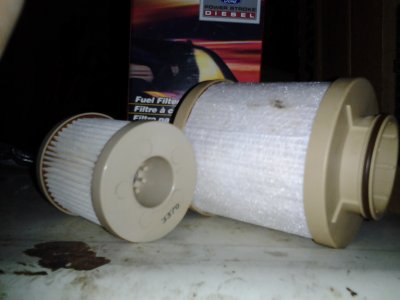

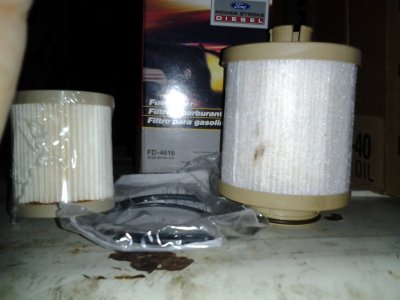

OK, here we go.... I just got back from doing the 115,000 service on my truck... just for reference, an oil change with 15qts of Valvoline Premium Blue, a Motorcraft FL-2016 Oil Filter, and a Motorcraft FD-4616 fuel filter kit, replacing both the Primary 10u on the framerail, and the 4 micron on the engine...
I took several pictures of the filters, included below are:
1. Motorcraft packaging
2. Contents removed from box, not unwrapped, Left - Secondary, Center - O-Ring kit for the caps, Right - Primary. Both filter have the "bottom", what goes into the housing first, facing down.
3. Both filters, Left - Secondary, Right - Primary, notice the water block membrane on the primary in the right.
4. Both "tops", the side that faces the cap, Secondary - Left, Primary - Right.
5. Bottoms, at an angle, notice the O-Ring on the "hat", that is a recent design change.
6. Insides, viewed from the bottom. There is a "tower" inside each housing that is inserted into the center of the filter when installed.
7. After replacement, these are the used cartridges, Secondary - Left, Center - Oil Filter, Right - Primary. The membrane is much more visible on the dirty one, you can just see the pleats through the membrane.
At this point, the truck is running better, I was having some stiction issues with the old, very dirty oil. Have a few minutes, the stiction has seemed to clear up, will find out in the morning when I head to work....
