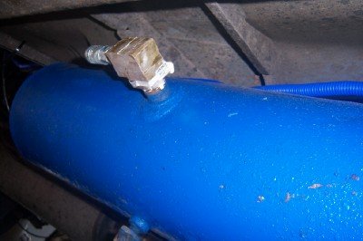

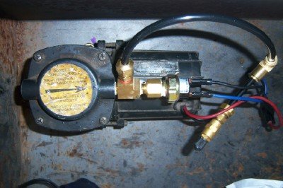

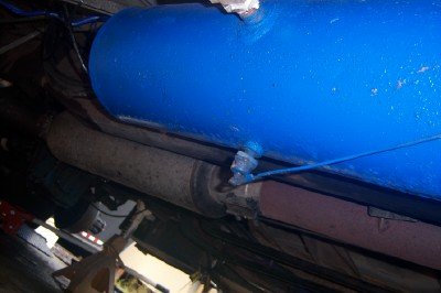

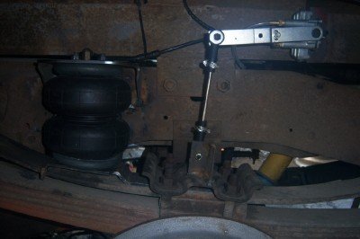

Well, I got it all together and it's testing ok for the most part. I've got a new compressor on order. My 26 year old salvage compressor has been sitting too long . It was working ok 6 years ago but it won't build over 25 lbs now, but at least thats plenty to test the works and it sure makes it ride nice. I set it up on a single leveling valve and my theory worked out, that rear end is so stinking stiff, it works just fine . I didn't set the valve to crank massive air to push the thing into the sky, I just wanted it to keep the thing settled After fireing it up I went a few miles and it raised teh truck about a quarter inch and smoothed the ride out very nicely.
The storage tank is off a semi trailer from between the axles, I rigged a quick disconnect for an air hose for air tools so I can run my impact wrench off the thing for changing tires , plus I have a line running to myy air seat so it's nice to just be ablole to push the button and have that work. There's a check valve in the compresor ( and the new one I'm getting) so I plumbed in a shrader valve to where if the compressor konks out, I can disconnect the leveler valve and pin it to where it wont vent air and then pump the bags up with an external compressor.

After the way this is feeling, come next year, I think I'm going to get another set of bags and eliminate the factory overload and mount the extra bags forward of the axle and have a 4 bag setup. THat ought to ride pretty sweet.
