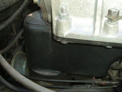

The missing line seems to eminate from the windshield cowl area, so in order to open the hood, the line would have to be removed. I'm going to guess it's a drug injection point. The butterflies might just close from their own weight, and then open when there is a vacuum on the back side. I'd like to see more of the belt arrangement, but considering the air box (which looks like the fabricator used an oil pan for the bottom) I'd have to agree it's functional. I'll give the builder credit for an original attempt! Don't know if it works worth a squat, but hey, somebody put a lot of love into it. ;Sweet

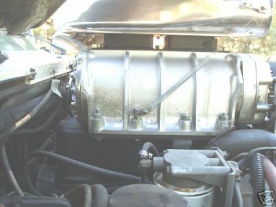

I'm not a really bright sort, can someone with blower experience explain to me how a CDR can function downstream of a blower pushing massive amounts of air into the intake?:confused:
honestly guys, it'd prolly be better if the seller just came foward and come clean that the darn thing is quite simply window dressing. Expensive and unique window dressing....

Yea I saw that and meant to mention it. Based on what I remember about one of those things, the CDR will open and the blower will presurize the crankcase as well, which is why every turbo kit manufacture has to move it from the stock location upstream of the turbo.

Shouldnt the CDR be moved or plugged????

If you guys look closely at the pic of the passenger side of the air box you will see the throttle cable AND the cruise control cable. That box really does look like an oil pan but I don't think a thin pan could handle the drive and weight of the blower. Nice work though.
