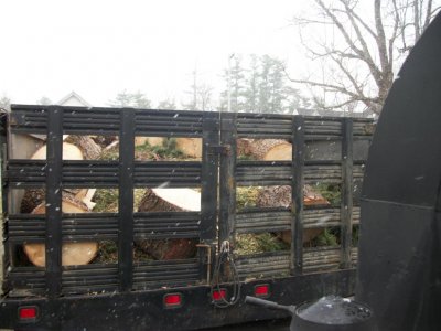

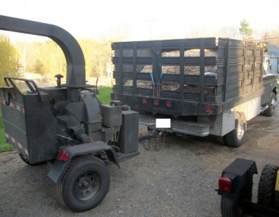

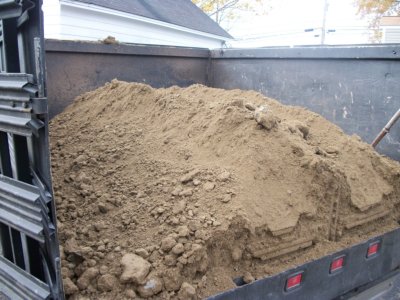

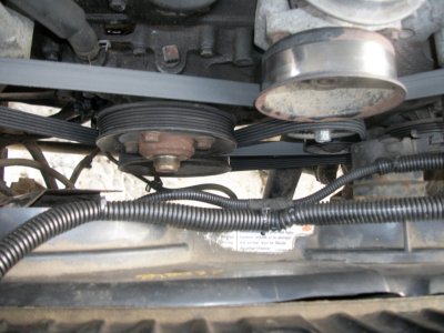

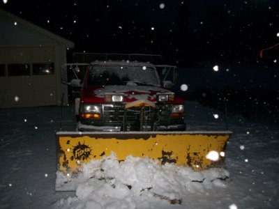

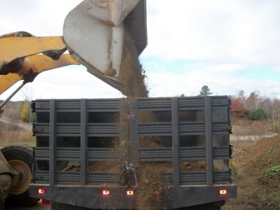

they're good for a few more things besides just hauling a loaf of bread and some milk.for example.here's my 8k lb truck (certified scaled)..........when empty,keeping cool very easily with the dual ford windstar cooling fan assembly.;Sweet
note,
the pic with the snow plow on..........by far the e-fans best workout to date.they can and do stay running for a while when that's on.any other condition in the summer......hardly break a sweat.
