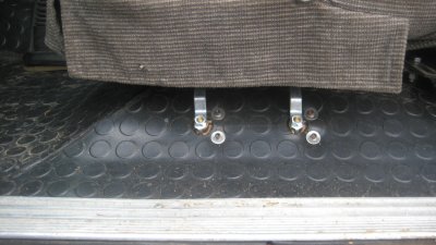

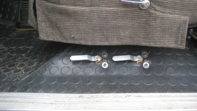

I got an annoying problem. I have no idea if my dual tank switch actually works in my van.
I went for a ride around the block, and it ran out of fuel at the other end of the block, fuel gauge was right on 1/2 mark.
Had to tow the damn thing with a 2wd F150...yeah that was interesting in snow covered roads!
Alright, so heres what I know...
I drove 2 hours to go get this van, and drove the van back that 2 hour trip, all highway. When we left where I bought it, BOTH tanks were at 1/2. originally the REAR tank was selected, but I switched to the FRONT tank to drive home.
All the way home, the gauge never moved! Once home I'm like ***? I then selected the REAR tank again, and now the Rear tank was damn near empty!
So is it possible that the selector valve is stuck on the rear tank.....but still reads for witch ever one is selected?
And heres a twist to all this, the gas gauge is ALWAYS live in this van, even with key off, turn signals, wipers, radio, everything works without turning the key on, so obviously someone has played with the wires under the dash..... could this be related? I have to keep the batteries disconnected to keep them from draining.
A little help would be very appreciated, never messed around with Dual tank problems before, I searched, but didn't find a similar problem to mine that has a clear answer.
(I did it get it running again by filling up the half empty fuel filter, and cracking open some lines, and dumped a 5 gal jerry can in the FRONT tank...)
