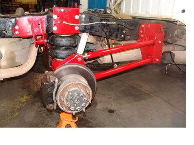

Fwiw I had a custom air ride suspension on a super duty years ago. It had traction bars. I was at the plant as they built and installed it. Anyway what they told me is that you wanted the bars to be as parallel to the frame/ground as possible. That could mean making some drop brackets like mine had to make that all happen.

Found an old pic of my traction bars on my super duty w/ air ride. notice how there is a drop bracket to try and get more parallel to the ground? This was with the bag fully inflated (about a 4" lift over stock) and not how I had it designed. Thats also a short bed pickup
Edit: argh... can't upload photos now with this site issue.... @ Alienturtle: shoot me a text and I'll send you the photo
