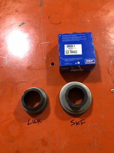

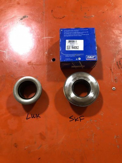

I have the exact same question; my Luk SMF kit throwout was damaged upon arrival, the the pilot bearing was destroyed. Got a new pilot and installed it.
I ordered a new SKF throwout bearing and it's substantially larger than the Luk. Looks like that won't be an issue, but if anyone has any input, please advise.
