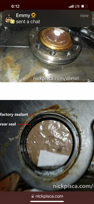

Well I did remove the sleeve to press it in…
And this picture does imply that I have it in backwards
Aswell as watching yt videos more clearly it also appears I installed it backwards and it’s stirring flush with the wrong side…
It’s becoming harder to pull transmission since I slipped a disc in my back so I can’t physically afford to pull the trans again so I have to be 1000% sure I’m doing it right this time and if that means I have to flip it around so be it

You have to. Install the seal so that it faces the same way when you put the sleeve back in to install the seal/plate.
Like this? Flush with the trans side?

Just now zooming in on your photos, yep that seal is in backwards. It's a 'spring seal' so it may hold for a while, but it's designed for crankcase pressure going one way, not the other. Eventually it'll leak.

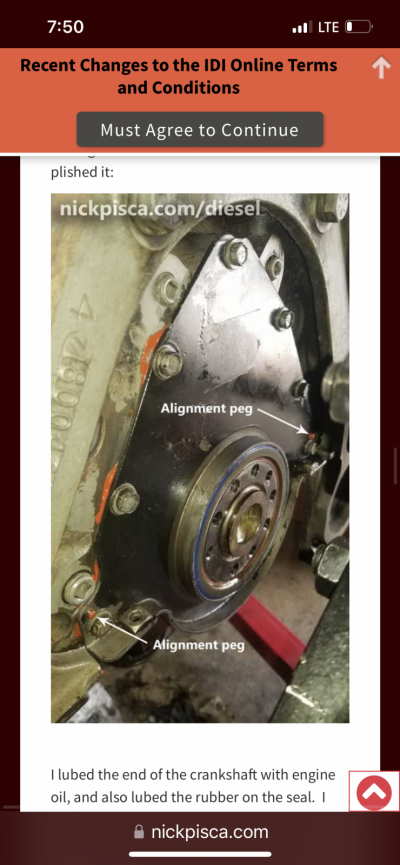

How’s this lookin y’all
Well shoot I didn't even know you could take that plate out! :frustrate :rotflmao
I installed mine in the engine without removing the plate. Still no leaks. Phew!
Any engine advice from Nick Pisca is gonna be good stuff. He used to be around here, van owner. Haven't seen him in a while. Anyway he knows his stuff about these engines. He takes lots of notes and has a lot of good tips and write-ups. I can't think of his screen name right now.
2,292
2,313
Yep its a seal carrier, is actually pretty common. It's so the seal can be centered on the crank, then you tighten down the retaining bolts.
