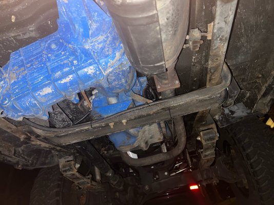

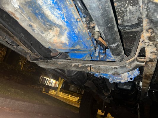

My 92 F250 is an original ZF truck and I swapped in a Dana 60 last year. I added extra springs in front so it sits higher than a standard F350 and I don't have any issues with clearance on the original crossmember. I have another F250 with a ZF and Dana 60 swap and a 4" suspension lift. That one is a lot tighter because of the sharper driveshaft angle.

Just took these. Leaky transfer case is leaking :cool:

Awesome! Thanks so much for taking those. Just found a F250 ZF5 one for sale not too far away. Thanks!

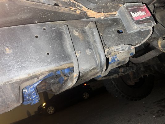

Checked your PM: You were 100% correct that I am unable to respond, so I have attached some pictures of my cross member here. It has 1 gusset on the driver side, and the passenger side just wraps around outside of frame. If our deal materializes, I will remove it ASAP and get it ready for shipping.
