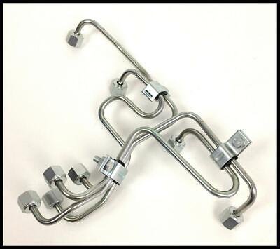

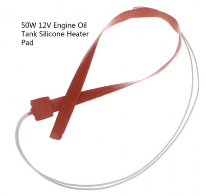

Hi yes, this is theoretical ofcourse;
1. the injection lines hold cold fuel that will get squirted in the engine first, until its all replaced by warm fuel from the fuel pump
2. the metal will be cold and cool down any new hot fuel until its all warmed up
I'll wrap this pad (only 4$) around the injector lines, powering them from the glowplugs (so they go on/off together). Will see if it makes a difference. Worth a try.
