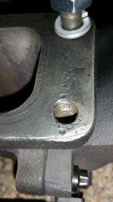

Let's assume for a second I'm telling the truth, and you were in my position, you opened up the rebuilt turbo you just installed a few months ago and saw this. Knowing there's nothing you did to cause it. I think you'd all be frustrated too when a vendor is unreachable, which is perfectly acceptable on a weekend, I just had plans to have this thing back on the road tomorrow and not it will be mid week at the earliest.
The aluminum looks pretty thick, would an oring bunched even be able to bend that? It looks like there is a knick right there though like a piece of rust or something got tightened between not an oring.

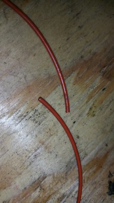

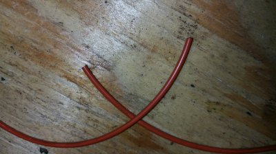

It wasn't my turbo I sent in, I didn't break any studs removing mine, they said they had a core they just had to drill a stud out to rebuild. I removed the one stud because it felt loser than the other 3 and it seemed it was slightly off center. I had to wobble the drill bit in that up pipe to get it lined up. Pics of the orings too, it's really flexible so I don't think it'd show a punch

Where can i even get the correct o-ring for this housing?
I have 100 of them.
That oring wont pinch enough to break the housing, I know this for a fact.lol
That really looks like shipping damage but its hard to tell for sure, I guarantee they would not ship it like that.
As far as clocking, I get all mine close and let the customer know it is close and will need to be final aligned and bolts snugged up after final install.
It is very difficult to get it right every time.

The 2 inner thoughts I had were...
1shipping damage(even if you had shipped a turbo in a refrigerator box the drivers/loaders could kill it) I see it all the time.
2 the line item senario ( my contracts used this format) had the same issue's.
