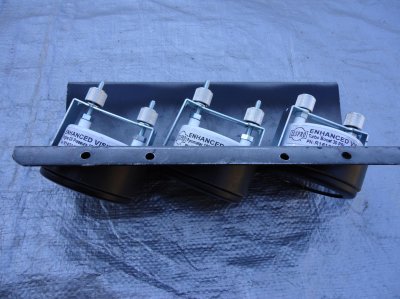

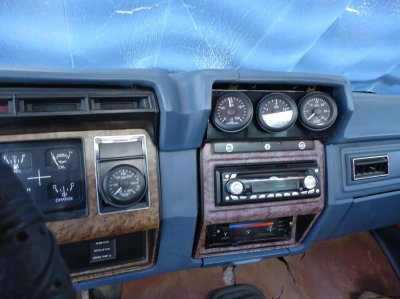

I made some angled pods using 2" ABS pipe. I think I cut them 22.5* I had some unused space above the radio, made a metal bracket and cut down the factory plastic. I don't have AC but have an AC dash, so used one of the AC vents for my water temp.

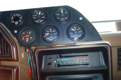

Very crude gauge set-up that was in my current project truck. The entire dash will be removed for replacement with grey dash. Four of these gauges will be moved to a four gauge pod on pillar. Pyro, 15psi Boost, mechanical oil pressure, mechanical temp.
hey it works!

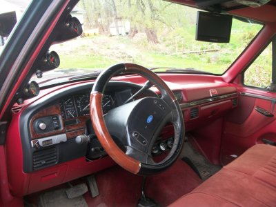

autometer/on the pillar from top to bottom;
oil pressure
water temp
trans temp
banks-dynafact/below the ash tray from left to right;
boost
pyro
oil temp (still no sending unit hooked up though.i put it off cus i know my aux cooler cured high temps.)
exact replica in log truck,minus oil temp.

My favorite gauge location. Pyro on top of the steering column. Right where it is in view of the tach and speedo.
I also have a 4 gauge pillar pod filled with stuff.
