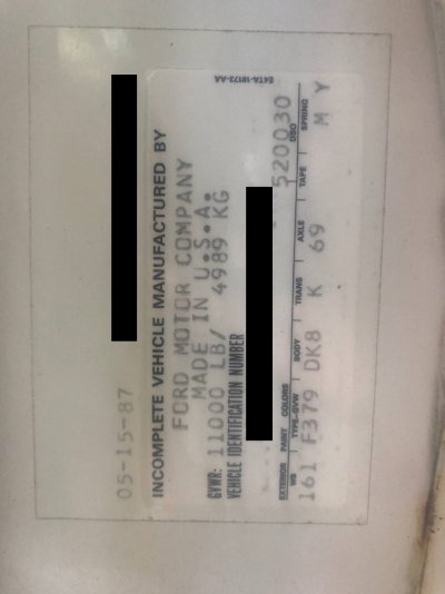

Im trying to figure out what differential I have. What can I look at to determine which one I have? Im trying to change the differential fluid but im not sure which one I have.

Check out the tag in the driver's door.. bottom row of letters
This is teh only sticker I have left on the drivers door. If it says it here I dont know where.

Under AXLE is says 69 So you it appears you have
A Ford 10.25 rear end, rated for 8250 lbs with 3.25 gearing

Sorry Im learning here. Im trying to figure out how much fluid and what type I need to change my differential fluid. What use would those two numbers give me in the future?

All you need to know from those numbers for your current question is it's a Ford (sterling) 10.25 rear axle.
Buy a gallon and after you've drained it fill it until it starts coming out of the fill plug. Looks like no limited slip so no need for an additive.
