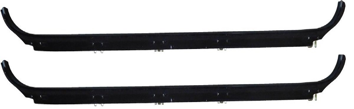

This is for your rear door,s, iners and outers

Goat that’s for an 87-97. The 80-86 rear doors had different style windows.
You can see how my green truck has 2 rear windows. One is stationary and the other goes up and down. On the new body style 87-97 they don’t have the rear stationary window, so the window that rolls up and down is going to be bigger.
