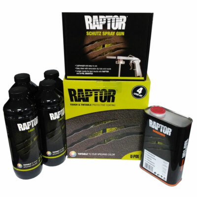

Powder coating tends to fail quickly once it's scratched. Hot dip galvanizing is much more effective and costs about the same. Sometimes less.
I used Raptor Liner on the exposed floor of my cab when I did the frame off resto years ago. It held up pretty well but isn't as durable as linex (although, linex is an entirely different process that can't be repeated at home). Raptor Liner cures very hard but can crack if you apply it too thick. A coat of fluidfilm has me sleeping easy, even if there are a few cracks here and there. Just don't use it on top of seam sealer or in areas prone to flex. Big mistake on my part.
